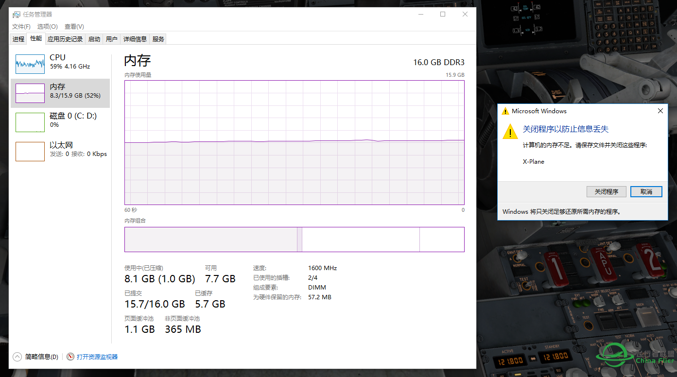

如果地景有问题,XP11会报内存用尽,很奇怪!
发表于 2017-6-19 20:53:39 | 显示全部楼层 |阅读模式

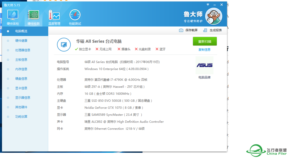

我的电脑配置如下:

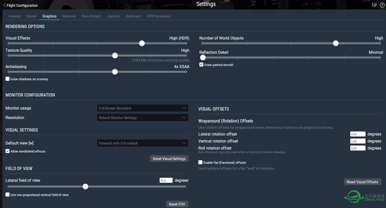

如果地景有问题,XP11会报内存用尽,很奇怪!-3084 XP11的画面相关设置如下:
如果地景有问题,XP11会报内存用尽,很奇怪!-6843
在飞KLAX的时候,内存占用到了52%就会报内存用尽,然后游戏就崩溃退出了,内存都没用完怎么就说用尽了呢(如下图)?如果是飞别的机场,就没有这个问题,关于KLAX地景的报错信息如下,好像是说静态飞机加载错误?麻烦大家帮我看看,怎么才能解决这个问题?
如果地景有问题,XP11会报内存用尽,很奇怪!-1934

0:01:31.872 E/SYS: +-------------------------------------------------------------------------------
0:01:31.872 E/SYS: | X-Plane is totally out of memory.
0:01:31.872 E/SYS: | Next time, turn down your rendering settings or remove add-ons to avoid this problem.
0:01:31.872 E/SYS: | If you cannot restart X-Plane you may have to delete your preferences, found in the Output folder.
0:01:31.872 E/SYS: | http://lookup.x-plane.com/_lookup_11_/no_mem.html
0:01:31.872 E/SYS: | (UTL_memory.cpp:1107)
0:01:31.872 D/STM: Transitioning from state state_NormalLoading to state_ShuttingDown
0:01:31.872 D/HID: HID Bridge Shutdown
----- X-Plane has shut down -----
